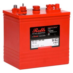

Rolls Surrette S6 GC2 Flooded Deep Cycle Battery 6 Volts 210 Amp-hours
Rolls Surrette S6 GC2 6 Volts 210 Amp-hours Deep Cycle Battery
This battery ships by truck freight only. It cannot ship via UPS or USPS. Please email us or give us a call if you have any questions.>
Rolls Battery has been manufacturing deep cycle batteries in Nova Scotia, Canada since 1959. Before moving into their current location, they began manufacturing batteries in 1935. That’s over 80 years of experience in the deep cycle battery market. Their batteries are used in a wide range of industries including railroad, marine, industrial & commercial, motive, and renewable energy. The Rolls Surrette line of batteries is becoming well known in the solar field. With uncompromised quality and craftsmanship, long life, durability, and overall great performance, our customers could not be happier with their investment.
The Rolls batteries can be used for both off-grid and grid-tie systems with battery backup. When using the batteries for off-grid installations, be sure your system is properly designed to bring the battery bank to a full charge within the limited number of sunlight hours for your region. If the batteries are not fully charged on a regular basis, you run the risk of discharging the battery bank beyond the 50% limit. This is what leads to warped plates and reduced amp-hour capacity.
| SURRETTE S6 GC2 SPECIFICATIONS | |
| Voltage | 6 Volts DC |
| Model Number | S6 GC2 |
| Surrette Series | 4000 |
| BCI Group Size | GC2 |
| Amp-hours @ 20 hour rate | 210 Amp-hours |
| Chemistry | Flooded Lead Acid |
| Weight | 61.5 lb (28 kg) |
| Length | 10.19 in (25.9 cm) |
| Width | 7.13 in (18.1 cm) |
| Height | 11.0 in (27.9 cm) |
| CYCLE LIFE VS. DEPTH OF DISCHARGE (DoD) | |
| 40% DoD | Approximately 1700 Cycles |
| 50% DoD | Approximately 1400 Cycles |
