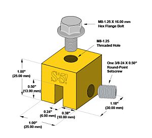

S-5! S-5-B Mini Brass Clamp for Copper Roofing
This clamp is specifically designed for double-folded copper standing seam paneling and batten profiles.
The S-5-B Mini is a medium-duty, non-penetrating seam clamp. It is a bit shorter than the S-5-B and has one setscrew rather than two. The Mini is the choice for attaching all kinds of rooftop accessories: signs, walkways, satellite dishes, antennas, rooftop lighting, lightning protection systems, solar arrays, exhaust stack bracing, conduit, condensate lines, mechanical equipment, etc.
Architects and roof designers choose copper roofing for its timeless elegance and durability. The S-5-B (“B” for “Brass”) allows architects to maintain that theme with all equipment and accessories that must be mounted to the roof with permanence and durability consistent with the roof itself.
The S-5-B clamp has been tested for load-to-failure results. Independent lab test data can be used for load-critical designs and applications. S-5! holding strength is unmatched in the industry.
