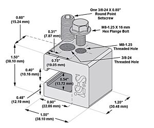

S-5! S-5-H90 Mini Roof Clamp for Horizontal Seams Greater Than 0.65 inches
The S-5-H90 is a one-piece clamp that was developed to securely and cost-effectively accommodate metal roof panels with a horizontal seam greater than 0.65". Turning the clamp 90 degrees so that the bolt hole side is facing up, slip the clamp on the seam and tighten the setscrews. After the clamp is installed, affix ancillary items using either of the two threaded bolt holes and bolt provided.
The S-5-H90 Mini is a bit shorter than the S-5-H90 and has one set screw and one threaded bolt hole rather than two. The mini is the choice for attaching all kinds of rooftop accessories: signs, walk ways, satellite dishes, antennas, rooftop lighting, lightning protection systems, solar arrays, exhaust stack bracing, conduit, condensate lines, mechanical equipment, etc.
