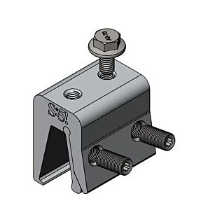

Designed specifically for 1-1/2” nail strip profiles with a wider horizontal dimension (> 0.475” and ≤ 0.800”), the S-5-NH 1.5 (“NH” stands for nail strip hinge) is an ideal mounting solution for VicWest Prestige, NewTech FF150 and similarly dimensioned profiles.
The innovative insert is a “hinge” design and features a toe to engage the female portion of the panel. It forms to the shape of the seam, preventing damage at the point of attachment, while offering you optimal holding strength. The hinge insert is also reversible to allow for proper fit on both wide and medium-width profiles.
For ease of installation, the T-30 Torx setscrews are angled upward to facilitate tool insertion. The hinged insert is also staked at one end to facilitate installation.
Product Specifications:
  • For use on 1.5” (38 mm) nail strip profiles
  • Fits 1-1/2" nail strip profiles - those with a wider horizontal base dimension (> 0.475” and ≤ 0.800”)
  • Reversible hinge for wide and medium-width profiles
  • Hinge forms to shape of seam, preventing damage at point of attachment
  • Toe on hinge engages female portion of panel for optimal holding strength
  • Hinged insert staked at one end to facilitate installation
  • Angled setscrews for ease of tool insertion
  • Heavy-duty applications like snow retention
  • Two T-30 Torx round-point setscrews (Torx bit tip provided)
  • One M8 bolt included
