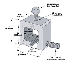

The S-5-Q Mini is a bit shorter than the S-5-Q and has one setscrew rather than two. The Mini is the choice for attaching all kinds of rooftop accessories: signs, walkways, satellite dishes, antennas, rooftop lighting, lightning protection systems, solar arrays, exhaust stack bracing, conduit, condensate lines, mechanical equipment—just about anything
The S-5-Q clamp was specifically developed to accommodate metal roof panels having a large, round “bulb” seam configuration up to 29 mm. It will also fit smaller bulb-shaped profiles that were not seamed correctly, allowing the seam to be utilized without modification.
With S-5-Q clamps, mounting heavy-duty applications to large or small bulb-shaped profiles just got a whole lot simpler! The S-5-Q is designed for heavy-duty applications such as snow retention. The S-5-Q can be used to mount S-5!’s ColorGard to bulb-shaped profiles, providing the strongest snow retention system on the market. The S-5-Q clamp was specifically developed to accommodate metal roof panels having a large, round “bulb” seam configuration up to 29 mm. It will also fit smaller bulb-shaped profiles that were not seamed correctly, allowing the seam to be utilized without modification. The clamp’s two-piece design allows it to be easily installed anywhere along the length of the rib, making installation a snap! The S-5! zero-penetration technology preserves the roof manufacturers’ warranties.
Installation is as simple as placing the clamp on the seam and tightening the round-point setscrew to the specified tension. Then, affix ancillary items using the bolt provided. Thanks to the round-tip setscrews, S-5! clamps do not pierce metal roof paneling, thereby protecting roof coatings and weather tightness warranties.
