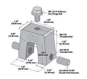

S-5! S-5-R465 Mini Metal Roof Clamp
The S-5-R465 and S-5-R465 Mini clamps are created specifically to fit the Zambelli RIB-ROOF 465, McElroy Metal’s Mirage II, Rib Roof Metal Systems’ Rib Roof and similar roof profiles.
The strength of the S-5-R465 clamp is in its simple design. The clamps are uniquely designed with opposing setscrews to maximize holding strength. The round-point setscrews do not penetrate the weathering membrane of the roof, nor damage the protective Galvalume coatings of steel panels. They will not cause scoring which can lead to roof material fracture or premature corrosion, including rust, thereby voiding the roof manufacturer’s warranty.
