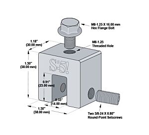

NOTE: The S-5-S Mini clamp does not come with mounting hardware. Bolts must be purchased separately. Please see the related items for bolt options.
The S-5-S Mini is a medium-duty, non-penetrating seam clamp. It is a bit shorter than the S-5-S and has one setscrew rather than two. The Mini is the choice for attaching all kinds of rooftop accessories: signs, walkways, satellite dishes, antennas, rooftop lighting, lightning protection systems, solar arrays, exhaust stack bracing, conduit, condensate lines, mechanical equipment, etc.
The S-5-S clamp was created specifically for popular snap-together profiles—including residential profiles by Taylor Metals and Easy Lock Standing Seam. For horizontal seams under .540 inches (like the Firestone UC4) the S-5-S or S-5-S Mini clamp can be used to avoid the necessity of crimping the seam. The S-5-S’s simple design and size make it perfect for use with S-5!® snow retention products and other heavy-duty applications. The S-5-S Mini clamp is a bit shorter than the S-5-S and has one setscrew rather than two. The Mini is the choice for attaching all kinds of rooftop accessories.
