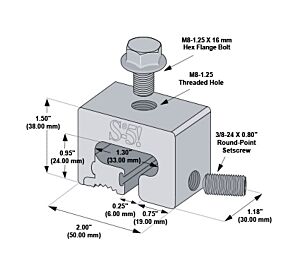

The S-5-T Mini is a medium-duty, non-penetrating seam clamp. It is a bit shorter than the S-5-T and has one setscrew rather than two. The Mini is the choice for attaching all kinds of rooftop accessories: signs, walkways, satellite dishes, antennas, rooftop lighting, lightning protection systems, solar arrays, exhaust stack bracing, conduit, condensate lines, mechanical equipment, etc.
The S-5-T clamp is specially developed to fit profiles having a “T” shaped seam configuration. It will also work on architectural “single-fold” or “horizontal seam” profiles having a horizontal projection of 5/8” or less. Its two-piece design allows it to be easily installed anywhere along the length of the panel seam. The S-5-T clamp is perfect for use with the S-5! ColorGard snow retention system and other heavy-duty applications. The S-5-T Mini clamp is a bit shorter than the S-5-T and has one setscrew rather than two. The Mini is the right choice for attaching all kinds of rooftop accessories.
