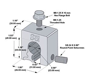

The S-5-Z Mini is a medium-duty, non-penetrating seam clamp and is a bit shorter than the S-5-Z and has one setscrew rather than two. The Mini is the choice for attaching all kinds of rooftop accessories: signs, walkways, satellite dishes, antennas, rooftop lighting, lightning protection systems, solar arrays, exhaust stack bracing, conduit, condensate lines, mechanical equipment, etc.
The S-5-Z clamp is specially developed to fit profiles having a round “bulb” seam configuration. Its two-piece design allows it to be easily installed anywhere along the length of the rib. The S-5-Z clamp is perfect for use with the S-5! ColorGard snow retention system and other heavy-duty applications. The S-5-Z Mini clamp is a medium-duty, non-penetrating seam clamp and is a bit shorter than the S-5-Z and has one setscrew rather than two. The Mini is the choice for attaching all kinds of rooftop accessories.
