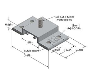

S-5! SolarFoot mounting platform
The SolarFoot is a simple, cost-effective pedestal for L-Foot (not included) attachment of rail-mounted solar PV. The unique design is compatible with all rail producer L-Foot components. The new SolarFoot assembly ensures a durable weathertight solution for the life of the roof. Special factory applied butyl co-polymeric sealant contained in a reservoir is The Right Way, allowing a water-tested seal. Stainless integrated stud and hex flange lock-nut secure the L-Foot into position. A low center of gravity reduces the moment arm commonly associated with L-Foot attachments. Direct attachment of the SolarFoot to the structural member or deck provides unparalleled holding strength.
SolarFoot Features:
  • Manufactured in the U.S.A. from certified raw material
  • Fabricated in our own ISO 9001:2015 Certified factory
  • All aluminum and stainless components
  • 25yr limited warranty
  • Compatible with all commercial L-Foot products on the market
  • Factory applied 40-year isobutylene/isoprene crosslink polymer sealant for reliable weathertightness
  • Sealant reservoir to prevent over-compression of sealant
  • Load tested normal to seam
  • Four points of attachment into structure or deck with tested holding strength for engineered applications
  • Integrated with M8-1.25x17mm stud and M8-1.25 stainless steel hex flange nut included
