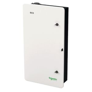

Schneider Electric Backup Control Switch
The BCS is designed to work with the Schneider Electric XW Pro inverter.
Whole home or partial home backup made easy. When paired with Schneider Electric XW Pro inverters, the Backup Control Switch (BCS) automatically disconnects from the grid during an outage, allowing the system to provide backup power to the home. The Backup Control Switch is used for larger XW Pro systems requiring up to 200 A rated MID or service entrance installation.
BCS Specifications:
  • Nominal Voltage: 120/240 VAC single phase
  • Maximum current rating: 200 Amps
  • Enclosure type: NEMA Type 3R outdoor rated
  • Dimensions: 35" x 19" x 7 3/4" (889 x 485 x 196mm)
  • Weight: 30 lb (13.6 kg)
