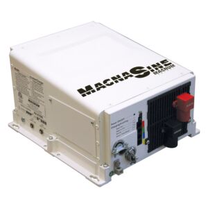

Important Information: The Magnum PAE inverters are rated for 240 Volts AC output. When powering 120 Volt devices, the inverter is not capable of delivering its full power output. The MS4448PAE is capable of delivering a maximum of 3,564 VA at 120 Volts AC.
The Sensata Magnum Energy MS4448PAE Inverter excels in renewable energy applications, offering 4400W output and 8500W peak power. It operates on 48VDC, providing pure sine wave energy across 120/240 VAC. The inverter is notable for its split phase capability, eliminating the need for stacking two units for 240V output. With the option to parallel up to four units, it's designed for both flexibility and high demand setups. Certified by UL and CSA for renewable installations, it meets the requirements of UL 1741 for Renewable Energy installations and CSA C22.2 No. 107.1-01 standards, ensuring reliability and performance. It boasts a warranty of 3 to 5 years.
Key Features & Specs
  • Input Voltage Range: 36-64 VDC
  • Nominal AC Output Voltage: 120/240 VAC split phase (± 5%)
  • Output Frequency: 60 Hz ± 0.1 Hz
  • Surge Power: 8500 watts for 1 msec, 6000 watts for 100 msec
  • Continuous Power Output: 4400 VA (L-L) at 25° C
  • Inverter Efficiency (Peak): 94%
  • Waveform: Pure Sine Wave
  • Charger Continuous Output: 105 ADC at 25° C
  • Power Factor: > .95
