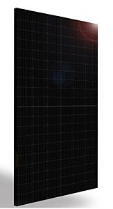

Silfab 370 Watt Monocrystalline Solar Module
Buy American Act Compliant: Silfab solar panels are proudly made in Ontario, Canada, North America.
Designed to outperform. Dependable, durable high-performance solar panels engineered for North American homeowners. Featuring 9-busbar technology that maximizes energy collection and conversion while high-efficiency, half-cell design improves performance and durability. The all-black design looks clean and elegant.
When you invest in Silfab modules, you’re not just getting maximum power density and long-term reliability, you are also getting premium quality modules with one of the most trusted warranty programs in the industry.
100% Maximum Power Density - Silfab’s SIL-370-HC ultra-high-efficiency modules are optimized for commercial projects where maximum power density is preferred. The modules are also suitable for residential home systems.
100% North American - Quality Matters - Silfab’s fully-automated manufacturing facility ensures precision engineering is applied at every stage. Superior reliability and performance combine to produce one of the highest quality modules with the lowest defect rate in the industry.
North American – Customized Service - Silfab’s 100% North American based team leverages just-in-time manufacturing to deliver unparalleled service, on-time delivery and flexible project solutions.
SIL-370-HC Specifications
  • Module Power: 370 Watts
  • Number of cells: 120 Half cells
  • Silicon Type: Monocrystalline
  • Vmp: 34.95 Volts
  • Imp: 10.60 Amps
  • Voc: 41.75 Volts
  • Isc: 11.25 Amps
  • Module Efficiency: 20.20%
  • Max System Voltage: 1,000 Volts DC
  • Power Tolerance: -0 / +5 Watts
  • Weight: 43.0 lbs
  • Dimensions (inches): 69.4" x 40.8" x 1.37"
  • Dimensions (mm): 1762 x 1037 x 35
  • Frame: Anodized aluminum
  • Connectors: MC4 compatible
Warranty: 12 year product warranty; 30 year linear power performance guarantee
