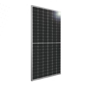

Silfab Commercial is a high-efficiency solar panel optimized for commercial projects where maximum power density and superior performance is essential. The half-cell technology is designed to improve the panel’s performance and durability. The durable silver frame is engineered to accommodate high wind and snow loads with front load validated up to 5400 Pa.
  • Power at Mpp: 530 Watts
  • Isc: 13.71 Amps
  • Voc: 47.74 Volts
  • Imp: 12.91 Amps
  • Vmp: 41.05 Volts
  • Efficiency: 22.3%
  • Cell: 132 Half cells mono PERC
  • Maximum system voltage: 1500 Volts
  • Connector type: MC4
  • Dimensions: 82.6" x 44.6" x 1.4" (35mm)
  • Weight: 57.8 pounds
Warranty: 25 year product warranty, 30 year performance warranty.
