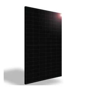

Silfab Solar 420w QD TOPCon (N-Type) module
Introducing the Silfab Solar 420W QD TOPCon (N-Type) Module – a state-of-the-art photovoltaic panel designed to deliver superior performance and reliability. Utilizing advanced N-Type TOPCon cell technology, this module sets the standard for residential and commercial solar applications, combining high efficiency, durability, and outstanding power output.
Key Features:
  • Advanced N-Type TOPCon Technology: Incorporates Tunnel Oxide Passivated Contact (TOPCon) technology with N-Type cells to minimize recombination losses, enhance electron mobility, and significantly boost efficiency.
  • High Power Output: With a robust 420W capacity, this module provides one of the highest power outputs in its class, making it ideal for installations where space is at a premium and maximizing energy production is crucial.
  • Superior Durability: Built to last with high-quality materials and stringent manufacturing standards, the Silfab Solar 420W module is designed to withstand harsh environmental conditions without compromising performance.
  • Aesthetic Design: Features a sleek, all-black design that not only improves the absorption of solar energy but also blends beautifully with any rooftop, enhancing the aesthetic appeal of modern homes and buildings.
  • Low Degradation: The use of N-Type silicon reduces the Light Induced Degradation (LID) effect commonly seen in P-Type modules, ensuring greater long-term yield and reliability.
Benefits:
  • Enhanced Efficiency: Achieves one of the highest efficiency ratings in the solar industry, which means more power generation per square foot of solar panels installed.
  • Cost-Effective Energy Solution: Reduces electricity bills and increases energy independence from utilities, delivering a quick return on investment through high output and efficiency.
  • Eco-Friendly Energy: Supports sustainable energy initiatives by reducing carbon footprint and promoting clean, renewable sources of energy.
  • Reliable Investment: Long-lasting and durable design backed by a robust warranty, ensuring peace of mind and a secure investment in renewable energy.
  • Module power: 420 Watts
  • Number of Cells: 108 Half cells
  • Vmp: 33.08
  • Voc: 38.84
  • Imp: 12.7
  • Isc: 13.5
  • Module efficiency: 21.5%
  • Dimensions (inches): 67.8" x 44.6" x 1.37"
  • Dimensions (mm): 1721 x 1133 x 35
  • Weight: 46.3
