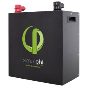

NOTE: The second picture shows the battery with the optional wall mount bracket. The bracket does not come with the battery.
