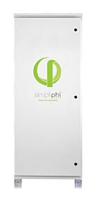

SimpliPhi Power A-3PHI-SCH AccESS Pre-built system with three PHI 3.8 kWh Batteries
A-3PHI-SCH
Note: This product has been discontinued, please look at A-4PHI-SCH-PRO. Should you need assistance or if you would like to explore alternative recommendations, please Contact Us or call us directly at 800-383-0195.
SimpliPhi Power A-3PHI-SCH ACCESS pre built system
This pre-built system can only ship via freight truck. It can NOT ship via UPS or USPS. Please email us or give us a call if you have any questions.
SimpliPhi Power designs and manufactures efficient, non-toxic and enduring energy storage and management systems that utilize lithium ferro phosphate (LFP). Based in California, SimpliPhi combines non-hazardous LFP chemistry with its proprietary cell and battery architecture, power electronics, battery management system (BMS) and manufacturing methods to create safe, reliable, durable and highly scalable on-demand power solutions. Available for the residential, commercial, military and emergency response markets, SimpliPhi storage solutions have been rigorously tested and passed operational performance requirements by the U.S. Army and Marine Corps. Integral to all SimpliPhi solutions is a proprietary management system that further optimizes the life-cycle, round-trip efficiency rate, performance and durability of its batteries. SimpliPhi PHI 3.8 kWh 48V 60 Amp batteries are Certified to UL 1973 Standard.
  • Pre-programmed ESS for backup power, peak-shaving, and self-consumption of solar PV
  • Internal transfer switch automatically disconnects from the grid during power outages and provides standby power for critical circuits
  • Outdoor rated enclosure can be free-standing, or pad-mounted
  • 98% round trip efficiency
  • System monitoring by system control panel or Combox with remote system monitoring by web browser or mobile device app
  • No cobalt, thermal regulation, cooling, or risk of fire
  • Extended operating temperature
  • System control panel or Combox
  • Advanced LFP batteries with a 10-year warranty
What's included:
  • Schneider Conext XW Pro Inverter
  • SimpliPhi PHi 3.8 kWh- 48V Battery
  • Dimensions: 29.5” W x 76”H (w/feet) x 20” D
  • Weight: 600 lb
  • Enclosure rating: NEMA 3R Oudoor Rated
  • Mounting: Free-standing or Pad-mounted
SKUA-3PHI-SCH
