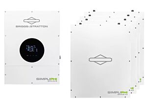

SimpliPhi Hybrid Inverter with integrated MPPT works seamlessly with the SimpliPHI 4.9 Battery, EnergyTrak, and Mobile App to deliver the most efficient, scalable, easy-to-use backup or primary power system available for homes and businesses
The SimpliPHI 4.9 kWh battery utilizes advanced Lithium Ferro Phosphate (LFP) chemistry to deliver more efficient, safer and reliable energy storage. Designed and built with versatility in mind, the SimpliPHI 4.9 kWh Battery seamlessly integrates with all leading inverters, making it an ideal solution for battery replacement, expansion of existing systems or as a new installation. This leading-edge power storage solution is also at the core of the energy storage system, The most advance, safety-certified ESS available for homes and businesses.
- EnergyTrak - Energy management software platform with multi-layered monitoring and control gives you the information needed to effectively manage your SimpliPHI ESS
- Scale Power - Add inverters over time to increase power output for larger electrical loads
- Scale Energy - Start small and add batteries to get you through extended power outages
- Versatile - IP 65 rated for indoor or outdoor installation, AC or DC Coupled, on or off grid
- Closed Loop Communication - Seamlessly integrate with other system components to streamline programming and ensure peak performance
- Battery Management System (BMS) - Integrated BMS protects the battery, creates additional safety, and extends cycle life
- Automatic Notifications - Mobile app provides remote visibility to maximize interoperability and minimize on-site support
- Superior Warranty - Up to 10 years, backed the power experts at Briggs & Stratton
Inverter Specifications:
- System voltage: 48 Vdc
- Rated AC output power: 6000 VA
- PV panel MPPT Voltage: 120 - 550 Vdc
- Max usable PV power: 15A per MPPT (2 MPPTs)
- Max PV array power: 7,500 Watts
- AC frequency: 50/60 Hz (auto recognition)
- AC output voltage: 105.5 - 132 Vac
- Extensibility: up to 9 units in parallel
- Dimensions (WxHxD): 20.28" x 27.55" x 8.5" inches
- Weight: 86 lbs
Battery Specifications:
- DC nominal voltage: 51.2VDC
- Amp-Hours: 97 Ah
- Rated kWh Capacity: 4.9kWh DC @ 100% DOD
- Max. Continuous discharge rate: 48.5 amps DC
- Max. Continuous charge rate: 48.5 amps DC
- Dimensions(h x w x d): 28.5" x 23" x 8.5"
- Weight: 160 lbs(per battery)
