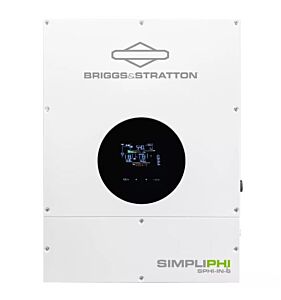

SimpliPhi Hybrid Inverter with integrated MPPT works seamlessly with the SimpliPhi 4.9 Battery, EnergyTrak, and Mobile App to deliver the most efficient, scalable, easy-to-use backup or primary power system available for homes and businesses.
  • Multiple Energy Sources - Designed to pair with solar, grid or generator in either AC or DC coupled configurations
  • Versatile - On the grid or off, with or without batteries
  • Scalable - Add up to 9 inverters for increased load support for a total of 54 kW
  • Seamless Transition - Less than 8 millisecond switchover time protects sensitive electronics and minimizes downtime
  • Digital interface - Easy programming and monitoring of primary system functions on the LCD screen
  • EnergyTrak Enabled - Remote monitoring and quick 5-step commissioning through EnergyTrak mobile app
  • IP 65 - rated for indoor or outdoor installations
  • System voltage: 48 Vdc
  • Rated AC output power: 6000 VA
  • PV panel MPPT Voltage: 120 - 550 Vdc
  • Max usable PV power: 15A per MPPT (2 MPPTs)
  • Max PV array power: 7,500 Watts
  • AC frequency: 50/60 Hz (auto recognition)
  • AC output voltage: 120/240 Vac
  • Extensibility: up to 9 units in parallel
  • Dimensions (WxHxD): 20.28" x 27.55" x 8.5" inches
  • Weight: 86 lbs
