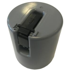

SJE-Rhombus Float Switch Cable Weight
Provides accurate pivot point for suspended float switches.
The Cable Weight is used in suspended float switch installations to provide an accurate pivot point for the floats. The gripper teeth on the clip and weight channel securely lock the float cable into place. It can be adjusted without the use of tools.
  • Gripper teeth on clip and weight channel securely lock float cable into place
  • Can be adjusted without the use of tools
HOUSING WEIGHT: 1 pound, 5 ounce (0.6 kgs)
HOUSING ENCLOSURE: 2.8 inches diameter x 3.3 inches long (7.1 cm diameter x 8.4 cm long), impact resistant, non-corrosive, PVC housing for use in liquids up to 140oF (60oC)
CLIP: Injection molded acetal plastic
WIRE/CABLE ACCOMMODATED: SJOW, SJTW, 18/2, 18/3, 16/2, 16/3, 14/2, 14/3
