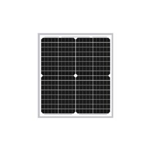

The ST-20P-12-R Solar Module leverages highly efficient monocrystalline solar cells and advanced manufacturing techniques, making it ideal for 12V off-grid applications such as traffic systems, safety devices, telecommunications, lighting, RVs, and marine equipment. Built with a robust aluminum frame, reinforced back plate, and a specialized junction box, this module is engineered to endure harsh weather conditions while consistently delivering reliable power.
  • Nominal Power: 20 Watts
  • Watt Class Sorting: -0/+5
  • Vmp: 18.53 Volts
  • Imp: 1.08 Amps
  • Voc: 21.37 Volts
  • Isc: 1.14 Amps
  • Panel Efficiency: 20%
  • Dimensions: 15.35" x 14.17" x 1.18" (30mm)
  • Weight: 4.00 lbs
