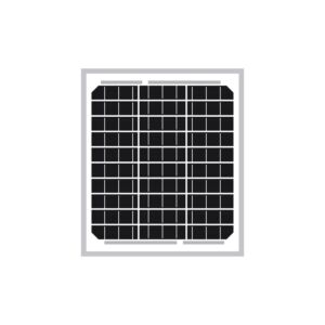

The ST-5P-12 Solar Module leverages highly efficient monocrystalline solar cells and advanced manufacturing techniques, making it ideal for 12V off-grid applications such as traffic systems, safety devices, telecommunications, lighting, RVs, and marine equipment. Built with a robust aluminum frame, reinforced back plate, and a specialized junction box, this module is engineered to endure harsh weather conditions while consistently delivering reliable power.
  • Nominal Power: 5 Watts
  • Watt Class Sorting: -0/+5
  • Vmp: 17.37 Volts
  • Imp: 0.29 Amps
  • Voc: 20.04 Volts
  • Isc: 0.30 Amps
  • Panel Efficiency: 20%
  • Dimensions: 8.86" x 7.68" x 0.71" (18mm)
  • Weight: 1.25 lbs
