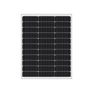

The ST-65P-12 Solar Module utilizes high-efficiency monocrystalline solar cells and advanced production technology, making it an excellent choice for a variety of 12V off-grid applications, including traffic systems, telecommunications, lighting, RVs, and marine equipment. Built with a robust aluminum frame, reinforced back plate, and a specialized junction box, this module is designed to withstand harsh weather conditions while consistently delivering reliable power output.
  • Nominal Power: 65 Watts
  • Watt Class Sorting: -0/+5
  • Vmp: 19.11 Volts
  • Imp: 3.41 Amps
  • Voc: 22.04 Volts
  • Isc: 3.59 Amps
  • Panel Efficiency: 20%
  • Dimensions: 26.57" x 20.87" x 1.18" (30mm)
  • Weight: 9.43 lbs
