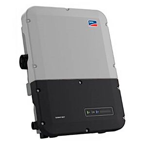

SMA Sunny Boy "No WiFi" 3.8-1SP-US-41 3840 Watt Transformerless Grid-tie String Inverter
SB3.8-1SP-US-41-NO-WIFI
Note: This product is at End of life.
SMA Sunny Boy 3.8-1SP-US 3840 Watt Inverter
SMA America has removed the WiFi feature of some products due to supply chain issues. A hard-wired network connection will still work, or using an optional cellular network connection.
Sunny Boy 3.8-US Features & Specifications:
  • Maximum PV Power: 6,144 Watts
  • Maximum DC Voltage: 600 Volts
  • AC Nominal Power: 3,330 Watts @ 208V | 3,840 Watts @ 240V
  • AC Apparent Power: 3,330 Volt-Amps @ 208V | 3,840 Volt-Amps @ 240V
  • Nominal Voltage (adjustable): 208 / 240 Volts AC
  • AC Voltage Range: [183-229VAC for 208VAC systems] and [211-264VAC for 240VAC systems]
  • AC Grid Frequency: 50 Hz or 60 Hz
  • Power Factor: 1
  • Output Phases: 1
  • Maximum Efficiency: 97.3% @ 208V & 97.6% @ 240V
  • Environmental Protection Rating: NEMA 3R
  • DC Disconnect Device: Yes
  • DC Reverse Polarity Protection: Yes
  • Ground Fault Monitoring / Grid Monitoring: Yes
  • AC Short Circuit Protection: Yes
  • All-pole Sensitive Residual Current Monitoring Unit (RCMU): Yes
  • Arc Fault Circuit Interrupter (AFCI): Yes
  • Internal Power Consumption at Night: <5 Watts
  • Topology: Transformerless
  • Cooling: Convection
  • Dimensions: 21.1" x 28.5" x 7.8"
  • Weight: 57 pounds
  • Warranty: 10 Years
