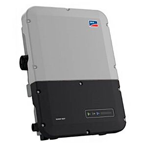

SMA Sunny Boy 3.8-1SP-US-41 3840 Watt Transformerless Grid-tie String Inverter
Note: This product is at End of life.
SMA Sunny Boy 3.8-1SP-US 3840 Watt Inverter
SMA America has removed the WiFi feature of some products due to supply chain issues. A hard-wired network connection will still work, or using an optional cellular network connection. SMA is on an industry-wide back-order. They are unable to give us ETA currently. Until then, please take a look at the "no WiFi" version of this inverter.
Sunny Boy 3.8-US Features & Specifications:
- Maximum PV Power: 6,144 Watts
- Maximum DC Voltage: 600 Volts
- AC Nominal Power: 3,330 Watts @ 208V | 3,840 Watts @ 240V
- AC Apparent Power: 3,330 Volt-Amps @ 208V | 3,840 Volt-Amps @ 240V
- Nominal Voltage (adjustable): 208 / 240 Volts AC
- AC Voltage Range: [183-229VAC for 208VAC systems] and [211-264VAC for 240VAC systems]
- AC Grid Frequency: 50 Hz or 60 Hz
- Power Factor: 1
- Output Phases: 1
- Maximum Efficiency: 97.3% @ 208V & 97.6% @ 240V
- Environmental Protection Rating: NEMA 3R
- DC Disconnect Device: Yes
- DC Reverse Polarity Protection: Yes
- Ground Fault Monitoring / Grid Monitoring: Yes
- AC Short Circuit Protection: Yes
- All-pole Sensitive Residual Current Monitoring Unit (RCMU): Yes
- Arc Fault Circuit Interrupter (AFCI): Yes
- Internal Power Consumption at Night: <5 Watts
- Topology: Transformerless
- Cooling: Convection
- Interfaces: Ethernet / WLAN
- Dimensions: 21.1" x 28.5" x 7.8"
- Weight: 57 pounds
- Warranty: 10 Years
