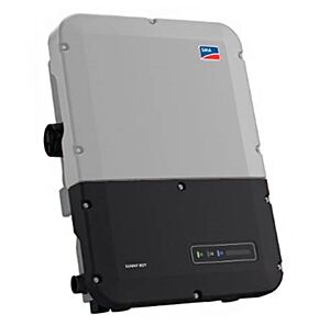

SMA Sunny Boy "No WiFi" 6.0-1SP-US-41 6000 Watt Transformerless Grid-tie String Inverter
SB6.0-1SP-US-41-NO-WIFI
SMA Sunny Boy 6.0-1SP-US 6000 Watt Inverter
SMA America has removed the WiFi feature of some products due to supply chain issues. A hard-wired network connection will still work, or using an optional cellular network connection.
