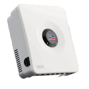

SMA Sunny Boy Smart Energy SBSE5.8-US-50 Hybrid PV + Storage Grid-Tie Inverter
SMA Sunny Boy Smart Energy SBSE5.8-US-50 Hybrid Grid-Tie Inverter
The SMA Sunny Boy Smart Energy hybrid inverter is designed to optimize home energy by enabling both immediate energy use and storage. This innovative system also offers SMA Backup Secure for power during grid outages. Its advanced features include 200% DC/AC design capability, 3 MPPT optimizing channels, and easy installation, making it an efficient solution for managing home solar energy.
