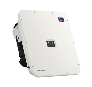

Introducing Sunny Tripower X, the smart and flexible inverter solution for your commercial solar power needs. With three MPPT trackers and SMA ShadeFix technology, you can customize your PV array design to suit any site conditions and maximize your energy production. Sunny Tripower X also offers integrated rapid shutdown and DC AFCI features for enhanced safety and reliability. Plus, with the new System Manager powered by SMA’s ennexOS platform, you can easily manage your energy system across different sectors and applications. Sunny Tripower X is the ultimate inverter for your commercial energy system today and tomorrow.
Technical Data
- Maximum array power: 30000 Wp STC
- Maximum system voltage: 1000VDC
- Rated MPP voltage range: 345 V to 800 V
- Maximum operating input current: 24A
- Maximum input short-circuit current: 37.5A
- Nominal AC power: 20000 W
- Output phases / line connections: 3/3-PE
- Nominal AC voltage: 480V
- Maximum output current: 24A
- Weight: 77 lbs
- Shipping Dimension: 28.7" x 30" x 10.5"
