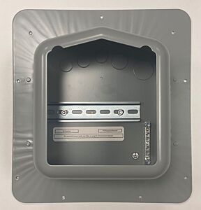

SolaDeck 0766-41AD – Roof-Mounted PV Combiner & Junction Enclosure
The SolaDeck 0766-41AD is a robust, roof-mounted PV combiner and junction box engineered specifically for deep tile and slate roof installations. Designed to simplify photovoltaic wiring and improve installation efficiency, this enclosure integrates a weather-tight flashed roof penetration with internal wiring space to protect and organize solar array connections.
  • Base and cover stamped from galvanized steel
  • 3/4″ Knockouts in sidewall to eliminate drilling
  • Din rail and ground block factory installed
  • 2/12 – 12/12 roof slopes
  • ETL listed and labeled
  • Conforms to the UL1741 standard, Nema Type 3R
  • CSA C22.2 No. 290
  • 1000 VDC/120A, 240 VAC/120A
  • Ambient temperature rating (-35°C) – (75°C)
