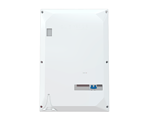

SolarEdge BI-E Home Backup Interface
The SolarEdge BI-E Home Backup Interface provides seamless whole-home or partial backup power by enabling automatic grid disconnection during outages. Designed for use with SolarEdge Home Hub and Energy Hub inverters, the BI-E enables fast, automatic transfer from grid to battery backup, helping homeowners keep essential or full loads powered during grid failures.
Rated for up to 200A main service panels, this device simplifies energy management by integrating with the SolarEdge ONE platform for smart load control and system monitoring. Its flexible installation options and support for both indoor and outdoor environments make it ideal for a variety of residential applications.
Key Features:
  • Enables whole-home or partial home backup
  • Supports automatic transfer and reconnection
  • Works with SolarEdge Home Hub & Energy Hub inverters
  • Rated for up to 200A main service panels
  • Indoor/outdoor rated for flexible installations
  • Integrated with SolarEdge ONE energy platform
  • Compatible with SolarEdge Home Battery 400V
  • Reduces installation time and system complexity
  • Model: BI-E
  • Max Service Panel Rating: 200A
  • Compatibility: SolarEdge Home Hub & Energy Hub inverters
  • Mounting: Wall-mounted
  • Location: Indoor / Outdoor
  • Enclosure Rating: NEMA 3R
  • Dimensions: 20.59" x 13.88" x 8.62" / (523.5mm x 352.5mm x 219mm)
  • Weight: 73 lbs (33 kg)
