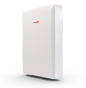

SolarEdge Home Battery 400V, 10kWh
The SolarEdge BAT-10K1P Home Battery is a high-voltage 400V lithium-ion energy storage solution designed for seamless integration with SolarEdge Home Hub and Energy Hub inverters. With a usable capacity of 9.7 kWh and total capacity of 10.3 kWh, this battery delivers reliable backup power, time-of-use shifting, and optimized solar self-consumption.
Stack up to three batteries per inverter for expanded capacity. The BAT-10K1P is certified for indoor and outdoor installation and supports floor or wall mounting for flexible site design. Domestic Content Eligibility makes it an ideal choice for projects seeking IRA compliance. Integrated with the SolarEdge ONE energy management platform, it provides real-time system optimization, smart load control, and remote monitoring.
Key Features:
  • 10.3 kWh total / 9.7 kWh usable capacity
  • 400V DC high-voltage design
  • Pairs with SolarEdge Home Hub & Energy Hub inverters
  • Domestic Content Eligible
  • Stackable: up to 3 batteries per inverter
  • Floor or wall-mounted, indoor/outdoor rated
  • Smart energy management with SolarEdge ONE platform
  • High round-trip efficiency: 94.5%
  • Model: BAT-10K1P
  • Total Energy: 10.3 kWh
  • Usable Energy: 9.7 kWh
  • Voltage: 400V DC
  • Weight: 269 lbs (122 kg)
  • Dimensions: 38.8" x 17.7" x 9.8" (985 x 450 x 250 mm)
  • Operating Temperature: -10°C to +50°C
  • Mounting Options: Floor or wall mount
  • Installation Location: Indoor / Outdoor
  • Scalability: Up to 3 units per inverter
