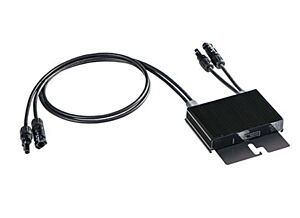

SolarEdge P401 Solar DC Optimizer
The SolarEdge Power Optimizer is a device that attaches directly to your solar module and uses MPPT technology to optimize the DC power before sending it to the inverter. The Power Optimizer is very similar to a microinverter. However, the Power Optimizers do not actually invert the DC power to AC power. The optimizers allow you to see system performance and diagnostics at the module level, similar to a microinverter, yet they last much longer due to the type of electronics used in the device. Microinverters have a much shorter lifespan vs a power optimizer. The SolarEdge optimizers come with a 25 year warranty, which means it's not too likely that you will ever have to service any of the devices once they're installed. Unlike a microinverter system, the Power Optimizers feed DC energy into a specifically designed inverter that maximizes the efficiency and output of the solar array.
  • Model number: P401
  • MPPT operating range: 8 - 80 VDC
  • Max short circuit current: 11.75 Amps Isc
  • Max efficiency: 99.5%
  • Max output current: 15 Amps
  • Max output voltage: 60 Volts
  • Dimensions: 5.08" x 6.02" x 1.16"
  • Weight: 1.5 lb.
  • Connector type: MC4 compatible
