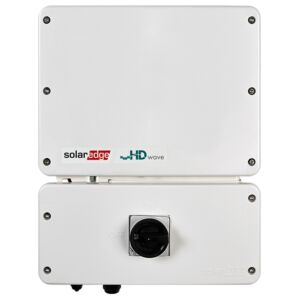

SolarEdge SE10000H HD-Wave Grid-Tie inverter 10000VA 240VAC
Note: Please call for availability.
Technical Note: This inverter requires the use of SolarEdge DC optimizers in order to work. If you do not install DC optimizers, this inverter will not function. Please email us or give us a call if you have any questions.
Click here to browse the SolarEdge optimizers, or see the related products section below.
SolarEdge HD Wave 10,000VA 240 Volts AC Grid-Tie Inverter
SolarEdge's HD-Wave technology inverter, winner of the prestigious 2016 Intersolar award, breaks the mold of traditional inverters. Using a novel power conversion technology that is based on a distributed switching and powerful DSP processing, the HD-Wave technology inverter is able to synthesize a clean sine wave that leads to a dramatic reduction in the magnetics and heavy cooling elements. This small and lightweight inverter enables simplified shipping and storing and one-person installation. The record-breaking efficiency allows more energy production for an improved ROI.
- Specifically designed to work with power optimizers
- 99% CEC weighted efficiency
- Up to 155% DC/AC oversizing allowed
- Longer strings
- Integrated Auto-Rapid Shutdown
- Faster commissioning with rapid pairing and 4 button touch panel
- Less heat & thin-film capacitors
- Optional built-in meter with ±0.5% accuracy
- Rated AC power output: 10,000 Volt-Amps
- AC output voltage: 240 Volts AC
- Maximum continuous output current: 42 Amps
- Built in GFDI protection: yes
- Utility monitoring: yes
- Islanding protection: yes
- Maximum DC power input: 15,500 Watts
- Maximum input voltage: 480 Volts DC
- Reverse polarity protection: yes
- CEC weighted efficiency: 99%
- Supported communication interfaces: RS485, Ethernet, ZigBee (optional), Cellular (optional)
- Revenue grade data, ANSI C12.20: optional
- Integrated arc fault protection for NEC 2011 690.11
- NEC 2014 690.12 shutdown compliant: yes
- Safety standards: UL1741, UL1699B, CSA C22.2, Canadian AFCI according to T.I.L. M-07
- Grid connection standards: IEEE1547, Rule 21, Rule14 (HI)
- RF emissions compliance: FCC Part 15 Class B
- AC Output Conduit Size / AWG Range: 0.75-1" Conduit / 14-6 AWG
- DC Input Conduit Size / # of Strings / AWG Range: 0.75-1” Conduit /1-2 strings / 14-6 AWG
- Dimensions with Safety Switch (HxWxD): 21.3" x 14.6" x 7.8"
- Weight with Safety Switch: 38.8 lbs
- Cooling: natural convection
- Protection rating: NEMA 3R for indoor and outdoor locations
12 year warranty
SolarEdge SE10000HD-US Data Sheet
SolarEdge SE10000HD-US Technical Specifications Supplement
