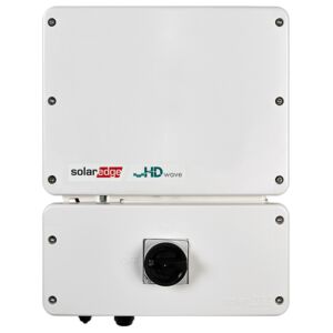

SolarEdge HD Wave 11,400VA 240 Volts AC Grid-Tie Inverter
SolarEdge's HD-Wave technology inverter, winner of the prestigious 2016 Intersolar award, breaks the mold of traditional inverters. Using a novel power conversion technology that is based on a distributed switching and powerful DSP processing, the HD-Wave technology inverter is able to synthesize a clean sine wave that leads to a dramatic reduction in the magnetics and heavy cooling elements. This small and lightweight inverter enables simplified shipping and storing and one-person installation. The record-breaking efficiency allows more energy production for an improved ROI.
  • Specifically designed to work with power optimizers
  • 99% CEC weighted efficiency
  • Up to 155% DC/AC oversizing allowed
  • Longer strings
  • Integrated Auto-Rapid Shutdown
  • Faster commissioning with rapid pairing and 4 button touch panel
  • Less heat & thin-film capacitors
  • Optional built-in meter with ±0.5% accuracy
  • Rated AC power output: 11,400 Volt-Amps
  • AC output voltage: 240 Volts AC
  • Maximum continuous output current: 47.5 Amps
  • Built in GFDI protection: yes
  • Utility monitoring: yes
  • Islanding protection: yes
  • Maximum DC power input: 17,650 Watts
  • Maximum input voltage: 480 Volts DC
  • Reverse polarity protection: yes
  • CEC weighted efficiency: 99%
  • Supported communication interfaces: RS485, Ethernet, ZigBee (optional), Cellular (optional)
  • Revenue grade data, ANSI C12.20: optional
  • Integrated arc fault protection for NEC 2011 690.11
  • NEC 2014 690.12 shutdown compliant: yes
  • Safety standards: UL1741, UL1699B, CSA C22.2, Canadian AFCI according to T.I.L. M-07
  • Grid connection standards: IEEE1547, Rule 21, Rule14 (HI)
  • RF emissions compliance: FCC Part 15 Class B
  • AC Output Conduit Size / AWG Range: 0.75-1" Conduit / 14-6 AWG
  • DC Input Conduit Size / # of Strings / AWG Range: 0.75-1” Conduit /1-2 strings / 14-6 AWG
  • Dimensions with Safety Switch (HxWxD): 21.3" x 14.6" x 7.3"
  • Weight with Safety Switch: 38.8 lbs
  • Cooling: natural convection
  • Protection rating: NEMA 3R for indoor and outdoor locations
