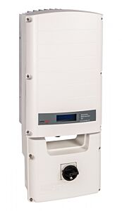

SolarEdge SE7600A Grid-Tie Single Phase Inverter 240 Volts AC
The SolarEdge single phase grid-tie inverters are designed to work with the SolarEdge Power Optimizers attached to your solar modules. The solar MPPT adjustments and voltage regulation are done at the optimizers, which means the main job of the inverter is to convert the DC power to AC power. This allows the unit to function more efficiently and consume less energy overall, in addition to making the unit more user friendly and cost effective. The fixed string voltage ensures operation at the highest efficiency at all times (>97% weighted efficiency) independent of string length and temperature. A data monitoring receiver has also been designed into the inverter. It collects data from all the Power Optimizers in your solar array. This data can be transmitted via the Internet to the SolarEdge monitoring portal, which gives you access to the data for monitoring system performance, detecting faults, and general troubleshooting.
Model number: SE7600A-US
Nominal AC power output: 7,600 VA (Volt-Amps)
Max. AC power output: 8,350 VA (Volt-Amps)
AC output voltage (minimum, nominal, max.): 211Vac, 240Vac, 264Vac
AC frequency range: 59.3 - 60.5 Hz
Max. continuous output current: 32 Amps
Max. DC power input: 10,250 Watts
Transformerless design
Max. input voltage: 500 Vdc
Nominal input voltage: 350 Vdc
Max. input current: 23 Amps
Max. inverter efficiency: 98%
Cooling: natural convection and internal fan (user replaceable)
Protection rating: NEMA 3R for outdoor locations
Dimensions: 30.5" x 12.5" x 7.2"
Weight: 54.7 lb
12 year warranty
