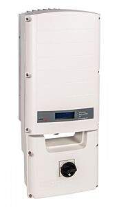

SolarEdge SE9KUS-208 Grid-Tie Three Phase 120/208Vac Inverter 9,000 Watts
SE9KUS-208
$2,706.52
Note: This product is discontinued.
Out of stock
SolarEdge SE9KUS-208 Grid-Tie Three Phase WYE Inverter 120/208 Volts AC
The SolarEdge three phase grid-tie inverters are designed to work with the SolarEdge Power Optimizers attached to your solar modules. The solar MPPT adjustments and voltage regulation are done at the optimizers, which means the main job of the inverter is to convert the DC power to AC power. This allows the unit to function more efficiently and consume less energy overall, in addition to making the unit more user friendly and cost effective. The fixed string voltage ensures operation at the highest efficiency at all times independent of string length and temperature. A data monitoring receiver has also been designed into the inverter. It collects data from all the Power Optimizers in your solar array. This data can be transmitted via the Internet to the SolarEdge monitoring portal, which gives you access to the data for monitoring system performance, detecting faults, and general troubleshooting.
Model number: SE9KUS-208
Nominal AC power output: 9,000 VA (Volt-Amps)
Max. AC power output: 9,000 VA (Volt-Amps)
AC output voltage L-N (minimum, nominal, max.): 105Vac, 120Vac, 132.5Vac
AC output voltage L-L (minimum, nominal, max.): 183Vac, 208Vac, 229Vac
AC frequency range: 59.3 - 60.5 Hz
Max. continuous output current (per phase): 25 Amps
Max. DC power input: 12,150 Watts
Transformerless design
Max. input voltage: 500 Vdc
Nominal input voltage: 400 Vdc
Max. input current: 26.5 Amps
Max. inverter efficiency: 97.1%
Cooling: fans (user replaceable)
Protection rating: NEMA 3R for outdoor locations
Dimensions: 21" x 12.5" x 10.5"
Dimensions with Safety Switch: 30.5" x 12.5" x 10.5"
Weight: 73.2 lb
Weight with Safety Switch: 79.7 lb
12 year warranty
