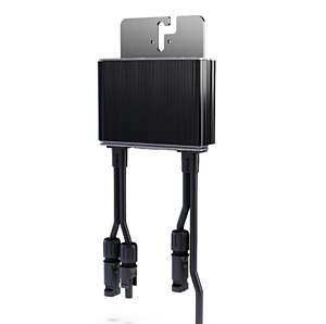

The SolarEdge U650B Power Optimizer is engineered for high-power and bifacial PV modules, delivering 650W output power with module-level MPPT to maximize energy production. Designed with a built-in mounting bracket, the U650B is ideal for frame-mounted and frameless solar panels where secure installation is essential.
With support for up to 100V max input voltage and 25A Isc, the U650B enhances system flexibility while minimizing mismatch losses due to shading or module aging. It integrates seamlessly with SolarEdge inverters and enables module-level monitoring and NEC 690.12 compliant rapid shutdown. Its IP68-rated enclosure ensures long-lasting outdoor performance.
Technical Specifications:
  • Max Power Output: 650W
  • Max Input Voltage (Voc): 100V
  • Max Short Circuit Current (Isc): 25A
  • Mounting: Frame-mounted with integrated bracket
  • Dimensions: 5.1 in x 6.1 in x 1.0 in (130 x 155 x 25 mm)
  • Weight: 1.6 lb (0.73 kg)
  • Enclosure Rating: IP68
