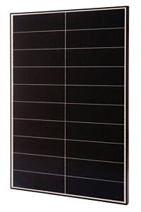

Solaria PowerXT-350R-BD 350 Watt Monocrystalline Solar Panel
PowerXT-350R-BD
Note: This solar panel is discontinued, Please look at our solar panel page. Please email us or give us a call if you would like help finding an alternative.
Solaria 350 Watt Monocrystalline Solar Module
Achieving up to 19.4% efficiency, Solaria PowerXT solar modules are one of the highest power modules in the residential solar market. Compared to conventional modules, Solaria PowerXT modules have fewer gaps between the solar cells; this leads to higher power and superior aesthetics. Solaria PowerXT residential modules are manufactured with black backsheet and frames, giving them a striking appearance. Developed in California, Solaria’s patented cell cutting and module assembly takes processed solar wafers and turns them into PowerXT solar modules. The process starts by creating a highly reliable PowerXT cell where busbars and ribbon interconnections are eliminated. Solaria then packages the cells into the PowerXT solar module, reducing inactive space between the cells. All of the above leads to an exceptionally efficient solar module produced in a cost effective manner.
PowerXT-350R-PD Specifications:
  • Nominal power: 350 Watts
  • Cell type: Monocrystalline Silicon
  • Vmp: 39.2 Volts
  • Voc: 47.4 Volts
  • Imp: 8.94 Amps
  • Isc: 9.44 Amps
  • Module efficiency: 19.4%
  • Dimensions (inches): 63.82" x 43.94" x 1.57"
  • Dimensions (mm): 1621 x 1116 x 40
  • Weight: 46 lbs (21 kg)
  • Connector type: Amphenol H4 (MC4 compatible)
Power and product warranty: 25 years
SKUPowerXT-350R-BD
