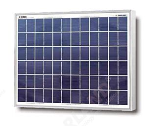

Solarland SLP012-12 Multicrystalline 12 Watt 12 Volt Solar Panel Class 1 Division 2
SLP012-12C1D2
Solarland Polycrystalline 12 Watt 12 Volt Solar Panel
SLP012-12 Specifications:
  • Has 30mm frame
  • Maximum power (Pmax): 12 Watts
  • Voltage at Pmax (Vmp): 17.0 Volts DC
  • Current at Pmax (Imp): 0.70 Amps DC
  • Short-circuit current (Isc): 0.77 Amps DC
  • Power tolerance: +/- 5%
  • Dimensions: 11.89" x 14.06" x 1.18"
  • Weight: 3.53 pounds
Warranty: 1-year limited warranty of materials and workmanship; 10-year limited warranty of 90% power output.
