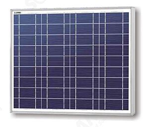

Solarland Polycrystalline 20 Watt 12 Volt Solar Panel
SLP020-12 Specifications:
  • Has 50mm frame
  • Maximum power (Pmax): 20 Watts
  • Voltage at Pmax (Vmp): 17.2 Volts DC
  • Current at Pmax (Imp): 1.16 Amps DC
  • Short-circuit current (Isc): 1.31 Amps DC
  • Power tolerance: +/- 5%
  • Dimensions: 22.68" x 14.06" x 1.97"
  • Weight: 6.17 pounds
Warranty: 1-year limited warranty of materials and workmanship; 10-year limited warranty of 90% power output.
