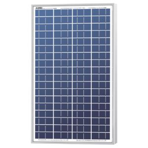

Solarland SLP020-24R Multicrystalline 20 Watt 24 Volt Solar Panel
Note: This panel is discontinued, Please look at the SLP020-24U.
SKU#: SLP020-24R
  $74.81
Solarland SLP020-24R multicrystalline 20 Watt 24 Volt Solar Panel
  • Maximum power (Pmax): 20 Watts
  • Voltage at Pmax (Vmp): 34.4 Volts DC
  • Current at Pmax (Imp): 0.58 Amps DC
  • Open-circuit voltage (Voc): 43.2 Volts DC
  • Short-circuit current (Isc): 0.68 Amps DC
  • Power tolerance: +/- 5%
  • Dimensions: 22.68" x 14.06" x 1.18" (30mm)
  • Weight: 6.17 pounds
  • Comes with junction box and 10 ft. 18/2 AWG cable with ring terminals.
