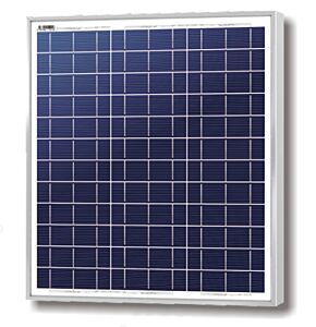

Solarland SLP030-12R Multicrystalline 30 Watt 12 Volt Solar Panel With 10ft Cable
The Solarland 30 Watt solar panel is perfect for off-grid charging for small batteries. Ideal for battery systems that require very little power and infrequent use.
Details
Solarland Polycrystalline 30 Watt 12 Volt Solar Panel
SLP030-12R Specifications:
- Maximum power (Pmax): 30 Watts
- Nominal voltage: 12 Volts DC
- Voltage at Pmax (Vmp): 17.2 Volts DC
- Current at Pmax (Imp): 1.74 Amps DC
- Open-circuit voltage (Voc): 21.6 Volts DC
- Short-circuit current (Isc): 1.93 Amps DC
- Power tolerance: +/- 5%
- Dimensions: 21.3" x 20.08" x 1.18"
- Weight: 10.25 pounds
- Pre-attached 10ft #18 AWG wire with positive (+) and negative (-) ring terminals and inline 3 Amp diode
- Rugged design to withstand high wind pressure, hail and snow load.
