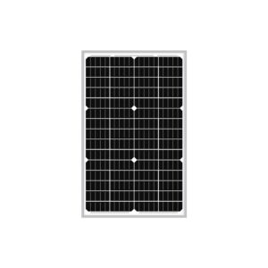

Solarland Monocrystalline 30 Watt 24 Volt Solar Panel
  • Maximum power (Pmax): 30 Watts
  • Voltage at Pmax (Vmp): 34.7 Volts DC
  • Current at Pmax (Imp): 0.87 Amps DC
  • Open-circuit voltage (Voc): 40.07 Volts DC
  • Short-circuit current (Isc): 0.91 Amps DC
  • Power tolerance: +/- 5%
  • Dimensions: 22.44" x 14.17" x 1.18"
  • Weight: 5.61 pounds
