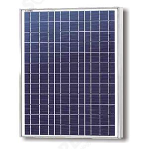

Solarland SLP045-12 Multicrystalline 45 Watt 12 Volt Solar Panel Class 1 Division 2
The Solarland 45 Watt solar panel is perfect for off-grid charging for small to medium capacity batteries. Ideal for battery systems that require little power and infrequent use. Great for keeping backup communications systems charged in remote locations. This module can be used to supplement RV battery charging. Rated for use in Class 1 Division 2 hazardous locations.
Details
Solarland Polycrystalline 45 Watt 12 Volt Solar Panel
SLP045-12 Specifications:
- Has 50mm frame
- Maximum power (Pmax): 45 Watts
- Nominal voltage: 12 Volts DC
- Voltage at Pmax (Vmp): 17.2 Volts DC
- Current at Pmax (Imp): 2.62 Amps DC
- Open-circuit voltage (Voc): 21.6 Volts DC
- Short-circuit current (Isc): 2.92 Amps DC
- Power tolerance: +/- 5%
- Dimensions: 25.79" x 21.14" x 1.97"
- Weight: 10.36 pounds
- Accessible junction box with positive (+) and negative (-) terminals.
- Rugged design to withstand high wind pressure, hail and snow load.
5-year limited warranty of materials and workmanship; 10-year limited warranty of 90% power output; 25-year limited warranty of 80% power output.
