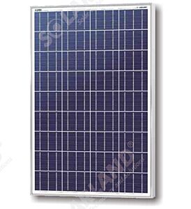

Solarland SLP090-12 Multicrystalline 90 Watt 12 Volt Solar Panel Class 1 Division 2 With 35mm Frame
SLP090-12C1D2-35mm
Note: This panel is discontinued, Please look at the Solarland SLP090S-12U.
Solarland Polycrystalline 90 Watt 12 Volt Solar Panel With 35mm Frame
SLP090-12 Specifications:
  • Has 35mm frame
  • Maximum power (Pmax): 90 Watts
  • Voltage at Pmax (Vmp): 17.9 Volts DC
  • Current at Pmax (Imp): 5.03 Amps DC
  • Open-circuit voltage (Voc): 22.1 Volts DC
  • Short-circuit current (Isc): 5.43 Amps DC
  • Power tolerance: +/- 5%
  • Dimensions: 37.01" x 26.57" x 1.38"
  • Weight: 17.42 pounds
SKUSLP090-12C1D2-35mm
