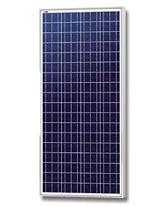

Solarland Polycrystalline 140 Watt 24 Volt Solar Panel
This module is rated for Class 1 Division 2 hazardous locations.
SLP140-24 Specifications:
This module can easily be connected in series with a second SLP140-24U module for charging 48 Volt battery systems. The accessible junction box makes it easy to wire the modules for your specific needs. Two SLP140-20U modules can be connected in parallel for twice the power for 24 Volt battery charging. When paired with an MPPT charge controller, the 24 Volt panel can be used to charge a 12 Volt battery.
  • Maximum power (Pmax): 140 Watts
  • Voltage at Pmax (Vmp): 36.6 Volts DC
  • Current at Pmax (Imp): 3.83 Amps DC
  • Open-circuit voltage (Voc): 44.0 Volts DC
  • Short-circuit current (Isc): 4.13 Amps DC
  • Power tolerance: +/- 5%
  • Rated for Class 1 Division 2 hazardous locations
  • Dimensions: 59.06" x 26.57" x 1.97"
  • Weight: 26.46 pounds
