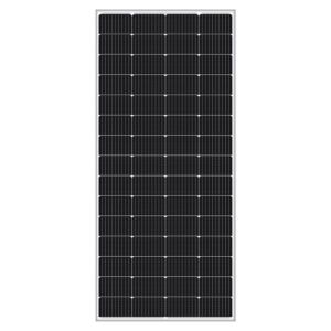

  • Maximum power (Pmax): 200 Watts
  • Module efficiency: 20%
  • Voltage at Pmax (Vmp): 33.73 Volts DC
  • Current at Pmax (Imp): 6.17 Amps DC
  • Open-circuit voltage (Voc): 39.21 Volts DC
  • Short-circuit current (Isc): 6.5 Amps DC
  • Power tolerance: ± 5%
  • Dimensions: 61.81" x 27.76" x 1.38" (35mm)
  • Weight: 26.84 pounds
  • 3 foot MC4 connection cables.
