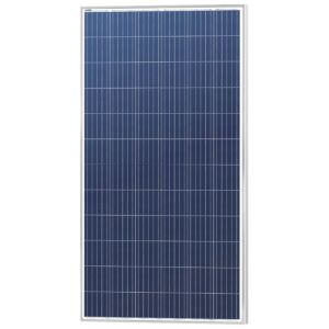

SLP330-24C1D2 Specifications:
  • Maximum power (Pmax): 330 Watts
  • Voltage at Pmax (Vmp): 37.79 Volts DC
  • Current at Pmax (Imp): 8.73 Amps DC
  • Open-circuit voltage (Voc): 44.79 Volts DC
  • Short-circuit current (Isc): 9.27 Amps DC
  • Power tolerance: ± 5%
  • Rated for Class 1 Division 2 hazardous locations
  • Dimensions: 77.01" x 39.06" x 1.57" (40mm)
  • Weight: 47.73 pounds
