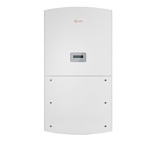

The Solis-(50-66)K three phase series string inverters are suitable for commercial and light industrial PV plants. These units have a compact and lightweight design making them an easy two-person installation. The ultra-low THDi of ˂2% and filter features add multiple layers of protection for the grid. Solis 50-66K inverters can be parallel-connected up to 6 MW. For easy installation and O&M, these units have a separable wiring box allowing the EPC to install the wiring box ahead of time and add the inverter at a later time. To finish it off these units have multiple options of communications with free Solis APPs and PC monitoring on SolisCloud.
  • Wide voltage range and low startup voltage
  • Transformer-less three phase design with 480Vac output
  • Max. efficiency 98.8% (CEC efficiency 98.4%) with ultra-low start up voltage
  • Designed for all commercial, industrial, and utility-scale applications
  • RS-485 Modbus communication protocol with Wi-Fi interface
  • 10 years standard warranty with extension options
  • Web-based data monitoring with downloadable Solis Mobile App
  • Compact and lightweight design inside a corrosion-resistant NEMA 4X enclosure
  • Industry-leading 4 MPPT designs with fast (<5 sec.) MPPT response times
Technical Specifications:
  • Max. input voltage: 1000V
  • Start-up voltage: 200V
  • MPPT number: 4
  • Max. input strings number: 16
  • Rated output power: 50 kW
  • Rated grid frequency: 60 Hz
  • Max. output current: 60.2 A
  • Max. efficiency: 98.8%
  • Dimensions: (LSW) 24.9in x 47.5in x 14.7 in
  • Weight(inverter/wiring box): (LSW) 147 lbs (66.7 kgs)/43.4 lbs (19.7 kgs)
