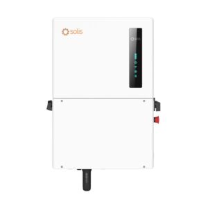

Solis S6-EH1P10K-H-US-RSS Hybrid Single Phase Four MPPT Inverter
The S6 (Series 6) hybrid energy storage string inverter is the latest Solis US model, certified to IEEE 1547-2018, UL 1741 SA & SB, and SunSpec Modbus standards. This high-efficiency PV string inverter provides economical, zero-carbon power and is built for all-weather conditions (Type 4X / IP 66). The S6 hybrid inverter can be DC-coupled with various batteries, offering a flexible solution for both off-grid and on-grid applications. This grid-forming inverter supports the latest high-powered PV modules, featuring 16A DC inputs at each MPPT. Protect your power supply while ensuring scalability and preserving your investment with the S6 hybrid inverter.
